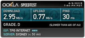

The download speeds while connected on Wi-Fi to the same router—an ADSL2+ Wireless N300 Modem Router—seems to be significantly faster on my phone than on my laptop. This problem doesn’t occur all the time, but the Internet connection on my laptop—which is running Ubuntu 14.10—occasionally reduces in speed and becomes unstable, while the Internet connection on my phone remains at the same speed and is continuously stable.
As a comparison, I performed a test on speedtest.com at the same time and the same location for my laptop and my phone during an “unstable connection phase” for my laptop.
I was wondering what potential causes there could be for this discrepancy?
Here are the speedtest results from my laptop (Lenovo Y50 UHD):

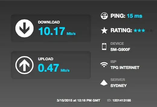

And here are the speedtest results from my phone (Samsung Galaxy S5):
Note that while the Samsung Galaxy S5 has a “Download Booster” feature which can use your Wi-Fi and mobile network simultaneously to increase download speed, for this test I turned off the mobile data completely on the Samsung Galaxy S5 but I still received similar results comparing my laptop and phone.

  • Can you please edit your question: You are providing some decent details on your phone and laptop, but what is the exact make and model of the Wi-Fi router you are using? The laptop seems to use an [Intel® Dual Band Wireless-AC 3160](http://www.intel.com/content/www/us/en/wireless-products/dual-band-wireless-ac-3160-bluetooth-brief.html). – Giacomo1968 Apr 07 '15 at 03:19
  • If you haven't already updated wireless drivers, I would suggest you do. There was a know issue with wifi performance for this laptop (and a few others from Lenovo). Let us know how you go. – Papa Apr 07 '15 at 03:33
  • @Papa: I believe all my wireless drivers for the Intel Corporation Wireless 3160 are updated, and I'm currently running Ubuntu 14.10. – astiara Apr 07 '15 at 03:47
  • Probably not the cause, but for elimination purposes, have you checked that the "_unstable connection phases_" aren't the result of other network activity running in the background (if, for instance, Ubuntu had something like Windows Updates) – TripeHound Apr 08 '15 at 10:16
