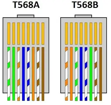

From experience (and I mean I have spent weeks figuring out why some PoE cables don't work and others do) I can say this: Ensure that your use RJ45 type B wiring and not type A for PoE. In some cases I have not been able to get type A to work. The power is transmitted, the powered device comes on, but there's no communication with the device, not even on layer2 (powered device MAC address is not visible on the switch).
So, use type B.
On a short cable (a few meters) it makes no difference, but on 70m+ it does. Using CAT5/5e or CAT6/6a cable, both cause problems on type A but not type B.
Type A and B (for CAT5 and 6)

As others have commented/answered, the "wire layout" (i.e. the color code) doesn't matter, the cable type (5/5e/6) determines signal properties (i.e. how far the signal can travel and at what "speed", etc.) so as long as the cable is POE capable (any 5+ cable, or CAT3 if less power is needed) and the switch/device is POE compliant (802.3af-at), the "color code" of the wire is more for any one coming up behind you to know your scheme (i.e. if it's wired all wonky, you might not be able to quickly tell if one cable is a pass-through or crossover ... not fun when 1 cable can stretch 200+ feet and there are 200 cables to dig through)
FYI: The "standards" that most use are the TIA/EIA 568 A/B termination standards.

DEFINITELY go with T568B {Orange Stripe, Orange, Green Stripe, Blue, Blue Stripe, Green, Brown Stripe, Brown}
It can make sense that as long as both ends are the same, it will work. NOT TRUE. I learned the hard way and had to redo many ends on POE because of this. Using the method mentioned above worked flawlessly every time. (200ft)
