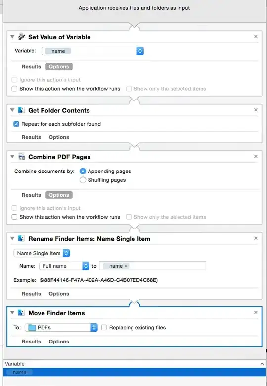

Update: Through Automator, I have it setup so all I need to do is drop a folder of PDFs onto it and it will combine, only problem is the renaming. I need it to rename the PDF as the folder name.
See Automator setup below: enter image description here

See Automator solution below, it saves the input folder name as a variable and then uses it again at the end. Not 100%, but close enough.
