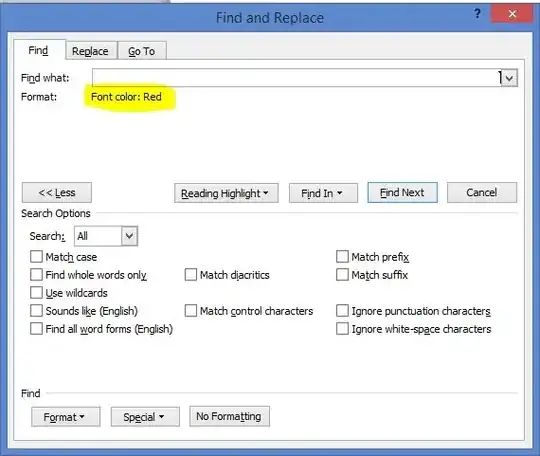

Searching for them is easy and relatively straightforward, even if not immediately obvious.
Ctrl-F will open the Find pane & then you can get to the dialog by clicking thus:
Advanced Find
Then you'll get this dialog:
Dialog
Click the More >> button
More
Click on the Format button, choose Font and then select the color you want to search for (i.e., Red)
Click OK. Now the Red attribute appears:
Red
Click Find Next & you're in business!
