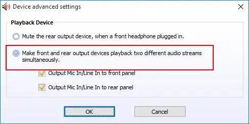

I just figured it out. It seems pretty counter intuitive, but works correctly.
You have to go into the advanced options. enter image description here
Then select "Make front and rear output playback two different audio streams". enter image description here
And presto. If you make the headphones your default device, then when you unplug the headphones windows falls back to the rear panel for audio.

  • Thanks. I know the method (I tried it before), yet I refused to go on with it since some applications (games mostly) require a restart after changing current audio output device. Without separating into two streams they do not need a restart. However, now I see that there is indeed no simple solution to that and yours are the best there could be without programming. – AgentFire Sep 02 '15 at 09:01
