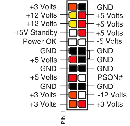

Hey all I am using an old Dell Precision R5400 which has the 750w hot swap-able power supply. Problem being, since its a dell, the ATX pin layout is different than that of a normal, standard ATX 2.0 power supply pin out.
What I found to be the Standard ATX 2.0 pinout: enter image description here
I have taken a volt meter to the R5400's ATX pinout and this is what I come up with:

Thankfully my motherboard's manual shows the pinout of it's ATX power supply connector: enter image description here
So some questions are still wondering inside my head:
1) What voltage should the PSON# be?
2) What voltage should the Power OK be?
3) As you see, I do not have access to a +5Vsb from the R5400 PSU.
   Can I just use a normal 5vdc for that (or somehow get 3.3vsb
   that I do have to work with it)?
Currently this is my pin-out for my new connector from the R5400 connector to the motherboard: enter image description here
So do you see anything wrong with the above? Just making sure as I do not want to fry a $500+ server motherboard over one wrong pin.

  • Your big problem will be the 5VSB. This needs to be supplied to the mobo before it can assert PSON# so you can't use a normal 5V line and 3.3V won't be enough. You may be able to feed the 3.3VSB into a boost regulator to get 5V but I don't know if the line will supply enough current. – DoxyLover Apr 24 '15 at 06:33
PSON is short for Power Supply On, so that is the same as PS-On from the ATX spec, and you can just power the power good with the 5v signal.
