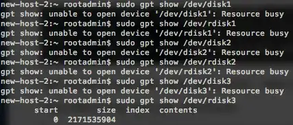

I also tried running sudo gpt /dev/(r)disk(1-3). Interestingly enough, the I only get a result from /dev/rdisk3:
sudo gpt /dev/(r)disk(1-3). /dev/rdisk3 gives a result

First off, the pdisk command is used to modify drives that are partitioned using an Apple Partition Map. Only PowerPC-based Macs use those.
Secondly, your umount commands above are failing because /dev/disk1 and /dev/disk2 are not mounted. Typically only partitions are mounted (e.g. /dev/disk0s3), although in your case, you have a Fusion Drive. You are absolutely correct that /dev/disk3 is not a 'real' disk. It is the combined capacity of /dev/disk1s2 and /dev/disk2s2. If you type umount /dev/disk3, that should work. Of course, nothing is mounted on /dev/disk1 or /dev/disk2, so you will have to issue a diskutil unmountdisk /dev/diskN for those. That should free them up so the gpt command will stop giving you the resource busy error.
Fusion Drives use Apple CoreStorage partitions as containers, which is sort of analogous to Microsoft's Dynamic Disks. Unfortunately, they make manipulating the partitions more difficult, and take many disk/partition recovery products off the table.
However, aside from the issues above, I'm not exactly sure what the problem is. You mention that the partition table is lost, but the output from diskutil list suggests your partition tables seem to be OK.
Can you elaborate a little more about the problem you were having?
