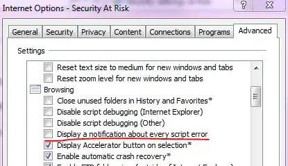

I have a wallboard setup to display statistics in the office, however the widget that uses embedded Internet Explorer keeps coming up with a JavaScript error.
The error can be closed without causing problems but it's irritating as it keeps coming back every so often around 2-3 times a day, and when it does it stops anyone from viewing statistics till it's closed by remotely accessing the wallboard. In regular Internet Explorer this can be easily stopped by unticking the option below.
My question is how to disable this script error pop-up in the Internet Explorer that's embedded into my widget?

As you can edit the registry, the following article lists many IE settings :
How to Customize Virtual Internet Explorer Settings.
To disable "Display a Notification about Every Script Error", use the following .reg file :
[HKEY_CURRENT_USER\Software\Microsoft\Internet Explorer\Main]
"Error Dlg Displayed On Every Error"="no"
