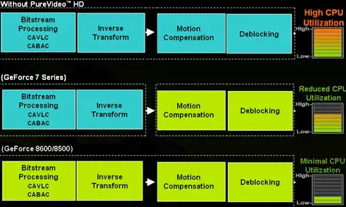

Chances are that any cinematics are encoded using h.264, this is quite likely as it would afford the highest quality visual with the lowest storage space cost. Given the relatively recent cards that the Wolfenstein series state as their minimum recommended card (see below) it is entirely possible that they expect to be able to fully offload all H.264 encoding to the graphics card, as every card after the G80 that yours is based on has a full decoding pipeline for h.264. Certainly every card since those they recommend (the GTX 460) would be able to decode the video entirely on the graphics card.
Your card though is a halfway house, it has some h.264 decoding abilities but not all of them. The G80 that powers your card was made before the chip that powers the 8600 in the image below. In terms of video decoding ability if it equivalent to the Geforce 7 series:
image borrowed from http://www.anandtech.com/show/2220
Your G80 chip is lacking several key parts to allow your system to fully offload the very intensive h.264 decoding task to the GPUs PureVideo decoder.
Which means that the game will either be offloading all of the video decoding to your CPU or, at the very least, a substantial quantity of decoding. How much decoding it offloads is dependant on whether the games use their own methods to display the video or whether they pass the video to Windows to play.
Either way this means that the CPU is doing the task of decoding something. If the game itself fell back to a built-in software decoder, it could be one that is poorly optimised for multicore processors. I would actually be surprised if your CPU cannot handle h.264 decoding using its own brute force.
I'm not entirely sure why they would be stuttering, as they should be failing over to full CPU decoding and you should have enough grunt to be able to do it, my only assumption would be that it is somehow trying and failing to properly use the video decoder on the GPU as it expects a more capable graphics card.
Depending on how the game displays the video (internal vs external codecs) there may not be an easy way fix it.
