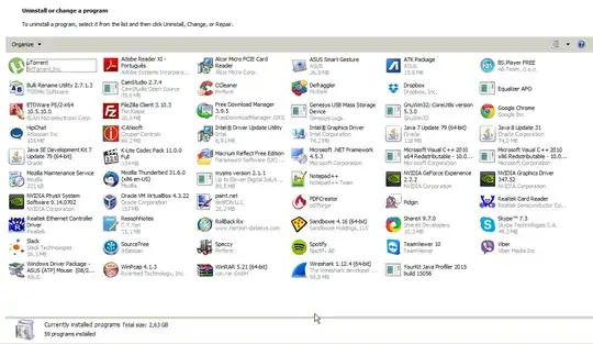

These are the apps I have installed:

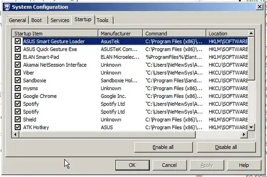

These are my startup apps:
enter image description here enter image description here (I always keep removing that Google Chrome from the startup but he insists going there, sucker... Also I cannot understand why I have two spotifies there, however no spotify opens at bootup as you can see from the video).

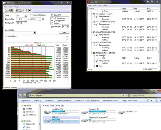

Disk performance tests

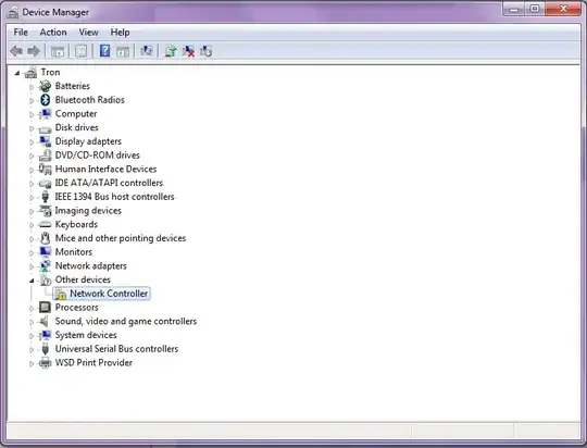

My device manager showing unknown devices

  • Hey, could you benchmark your hard drive (test read and write speeds)? [CrystalDiskMark](http://crystalmark.info/software/CrystalDiskMark/index-e.html) is very handy and you can just download the portable version to avoid installations. – Little Helper May 20 '15 at 11:33
  • You have a ton of stuff that is started at startup. In order to determine what takes your system 10 minutes to startup would involve a process of not starting any of that stuff one by one until you find the culprit. If you have 30% fragmentation that also can cause a problem, and unless you have a SSD, you should defrag your HDD – Ramhound May 20 '15 at 11:35

  • You also have a ton of "unknown devices" which means Windows spends time trying to communicate with them. You should also use the correct tools for the job, AutoRuns, is a great deal better then what your using. – Ramhound May 20 '15 at 13:34

B: You have a lot of programs in your startup, as you know. Each of these programs could potentially have a Scheduled Task to run on startup (even before login) so I strongly suggest turning off things like DropBox, Spotify, Asus Bloatware. These are things that soak up many resources on startup but wouldn't necessarily be too much to manually start on a need-to-use basis. Additionally, check the Scheduled Tasks as mentioned. Win+R > tasksched.msc Anything you remove from msconfig you should also disable here. Read individual tasks and decide if it's performing something you actually want done.

D: Dude, you've got to find those missing drivers. Check out PCI-Z to quickly google for your specific ones. Try and find them by looking up your model on the Asus website. Check out Driver Identifier it costs money for the direct downloads but is an excellent [free] tool for at least determining what keywords to look for. When you get the correct drivers you can easily make a backup of them using DoubleDriver
E: I know you ran CrystalDisk which is an excellent diagnostic tool but like anything it doesn't mean it's perfect. I would try running an offline/Live OS HDD Scan like MHDD, HDAT2, or a drive specific scan like Hitachi Drive Fitness Test. Even one bad sector (that CrystalDisk might not detect) could slow your boot up time to a crawl. Usually, that would mean the over all performance of the drive would slow, not just startup but it's still within the realm of possibility. (Could be the reason why you had issues defragging)

It looks like you are missing the Intel Chipset drivers. That could absolutely slow your computer down. Go install all those drivers from Asus: http://www.asus.com/Notebooks_Ultrabooks/K56CB/HelpDesk_Download/
