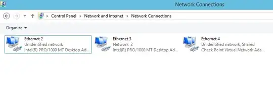

I have a CheckPoint VPN connection on Windows VM.
Ethernet 2 = Host only
Ethernet 3 = Bridged
Ethernet 4 = VPN. This is the one you will need to share with Ethernet 2 (hostony)
  • Right-click 'Properties'
  • Sharing tab
  • Share with 'Host-only' network
Then on my Ubuntu box: (192.168.222.50 is just a host on the corporate net)
sudo route add 192.168.222.50 via 192.168.56.11
Or route an entire range
sudo route add 192.168.222.0/24 via 192.168.56.11
Also, don't forget to add your corporate DNS server to the /etc/resolv.conf!
Rob Audenaerde
  • 195
    After sharing VPN with Host-only, I have to set IP from 192.168.137.1 back to 192.168.56.11, and use `ip route` instead of `route`. – guest Jun 04 '18 at 07:38
