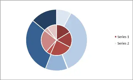

Excel can do this in a single chart (if you really want it too, that's up to you). It's actually pretty easy:
  1. Create a doughnut chart.
  2. Add both series (as in you sample, but you can have multiple rings).
  3. Adjust your series so that the your inside pie chart is Series 1.
  4. Change Series 1 chart type to Pie Chart.
  5. Format your Doughnut Chart Hole Size to 50% (or whatever suits).
  6. Format other colors and borders to suit.
Here's a sample
PieDoughnut
And, since it's a single chart, you can place it on a Chart Sheet or do anything else you can with a regular chart.
dav
  • 10,021
  • 52
  • Does this require the categories to be the same for the inner pie and outer rings? – Řídící May 29 '15 at 17:34
  • No, you can any number of categories in either/any ring. So, you could use the outer ring as a type of summary if you wanted. Just change your series data in the select data dialog box. – dav May 29 '15 at 17:36
