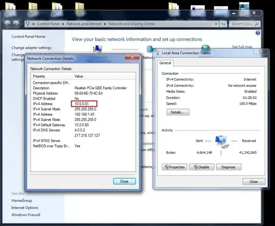

My system IP in the network is 10.0.0.81:

C:\Users>tracert -j 10.0.0.131 10.0.0.81
Tracing route to ghasemi3.it.com [10.0.0.81]
over a maximum of 30 hops:
  1    <1 ms    <1 ms    <1 ms  ghasemi3.it.com [10.0.0.81]
Trace complete.
C:\Users>
