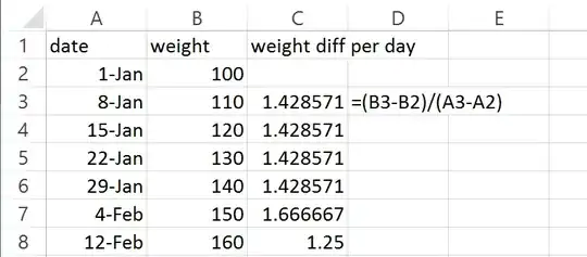

With Date in column A and weight in column B, row 1 has labels, use this in C3 and copy down
=(B3-B2)/(A3-A2)
Note that row 6 has only 6 days difference, row 7 has 8 days difference. The formula calculates weight difference divided by number of elapsed days.
