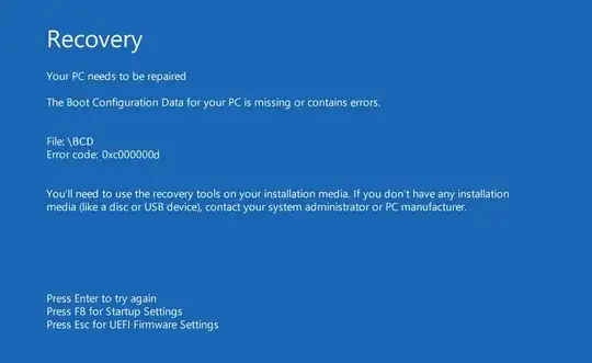

My laptop was not starting. I understood that the battery had run out of charging as soon as I plugged in the charger and started my laptop. Meanwhile, for a second I had removed the plug again and plugged in to another socket which corrupted my Windows 8.1 which was earlier upgraded from Windows 8.
Then it was showing me only a blue screen with Windows 8 error code oxc000000d.

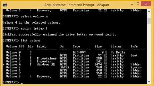

Update:Removing disk management to shorten the question. I assigned letter to my recovery partitions I'm able to see the files in it. Diskpart - ScreenGrab Here is Recovery drive - ScrrenGrab

Update 1: Since the Disk Management screenshot shows that the Recovery Partition wasn't overwritten, it may be possible to reinstall from that partition instead using the Fn + (number) combination to access Recovery. The combination is specific to your model of laptop.
The following method still works but by using the Recovery partition method, you are also installing the software which is usually bundled along with Windows preinstalled. You also won't need to redownload the correct version of Windows 8.
Update 2: It is indeed possible to reinstall Windows using the install.wim file, however it will be far more troublesome than just downloading the correct iso and installing Windows- you'll have to install WAIK(works for Win7 too). You boot to a command prompt when booting off the disc and have to partition and format the disk accordingly, then run a string of commands to apply the WIM file from your flashdrive.
