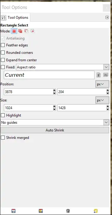

In GIMP, the status bar at the bottom of the window will show you the dimensions while you are selecting, but it disappears when you finalize the selection. I suspect that is because the selection can be shapes other than rectangle. If you want to see it afterwards, make sure the Windows --> Dockable Dialogs --> Tool Options pane is enabled. It may already be docked on your Toolbox. This will show you the position and size of a Rectangle Select. You can also modify the size of the selection from this pane.

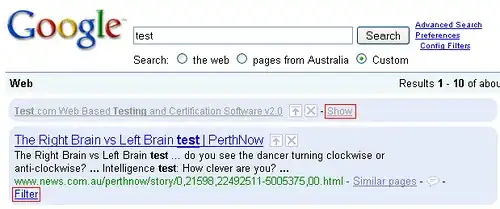

GIMP shows the ongoing selection dimensions in the status bar, just on the bottom of the window. enter image description here If that is not enough for some reason, there is a "measurement tool" you can pick on the toolbox (on the default configuration, just following the "zoom tool") - which will give you any linear size, and also angles of measured lines.

In the tool options window for rectangle select, you can see the size values
