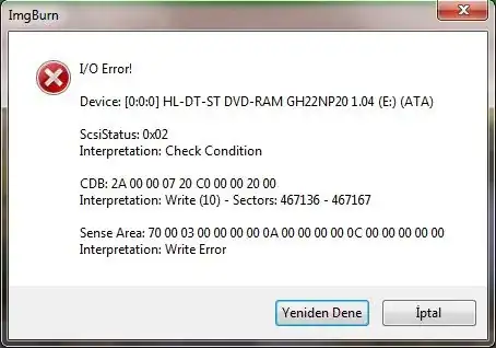

I'm using ImgBurn v2.5.0.0 (latest version). I'm trying to burn an image file (.dvd) which is together with the related .iso file in the same folder. In ImgBurn, I select the file with .dvd extension, and set writing speed to 2.4x. Burning process starts normally, but around 7% of the process, it gives a I/O Write Error, which is as follows:
I wasted 3 discs (Magic, Made in Taiwan, DVD+R DL, 8.5 GB) trying the same thing. My DVD writer is LG GH22NP20 with IDE connection type. I updated its firmware from 1.04 to 2.00 but no success in burning again. Then my cousin brought his LG (an older model) which, he claims, was successful in writing DL discs with the same brand (Magic). I plugged off my LG and plugged the older one in, and tried to burn the image again. It also gave an I/O Error even without standing till 7%. I tried another burning program (CloneCD), but failed again.

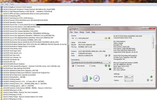

Then I bought other brands (TDK and VERBATIM) and tried to burn the image. Burning process started successfully, but around 14% (for Verbatim) and 25% (for TDK) failed again. Here is a screeny from ImgBurn:
I've burned lots of 4.7 GB DVD+Rs and DVD-Rs successfully, even without a single error, with this LG DVD writer, but this case is very bothering for me. What should I do? Should I buy a new DVD writer other than LG? Could this be related to Windows or my hardware configuration? Thanks for your help.
