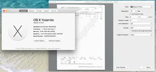

  • This procedure worked perfectly for me. I have an old Epson flat bed scanner. I'm running Yosemite. To start a new document, just change the destination file name. – Edward Falk Apr 30 '15 at 18:32

    In recent versions (10.8), Preview will let you scan directly into a combined document. There is a checkbox now for this in the Scan dialog. http://superuser.com/a/544836/4577 – Thilo Feb 01 '13 at 03:02

As of OS X 10.8, Preview can also do it. Follow these steps:
  1. Select "File" > "Import from Scanner".
  2. A dialog will open, with an overview of the document to be scanned.
  3. In that dialog, in the "Format" menu, select "PDF". If you do not see this dropdown, it's because you have to click on the "show details" button.
  4. Below will then appear the checkbox "Combine into single document". Check it.
Note: do NOT miss the 3rd step. If you don't select "PDF" as the format, the "Combine into single document" checkbox will NOT appear.

  • still working on OS X Yosemite 10.10.2 , thanks Thilo :) – Adriano May 05 '15 at 11:50
    Doesn't seem to work for me :( I can scan from printer dialog but menu option is disabled in preview. – Stop Slandering Monica Cellio Feb 15 '16 at 22:47
  • After picking Import from Scanner, if you don't see the options for Format and Combine..., click the Details button on the lower right. After scanning the pages, select File > Save to create a multipage PDF. Another approach (as noted in gibbosf's answer) is Preview > Print and selecting the PDF option in the print dialog. – Bill Hoag Sep 01 '22 at 03:11
