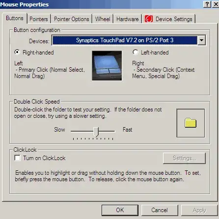

We have both left-handed and right-handed users in our house. It would be handy to be able to change this setting from the keyboard rather than using the Mouse control panel. Is there a way to assign a keyboard combination to this function?
Edit: I realized after a few answers came in that some of the answers aren't working because of the Synaptics software that came with my HP Netbook. This software (or maybe something else, not sure) modifies my mouse control panel to look like this:

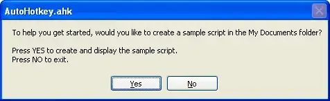

After installing AutoHotkey, run it; you'll get a dialog to make a script:
Hit Yes and paste the above code into the file, save it. Now run AutoHotkey again so it sits in your tray. It will now listen for the key combinations above until you right-click its tray icon and exit it.

  • After some registry exploration, I thought that maybe I could just change Control Panel\Mouse to Software\Synaptics\SynTPCpl\TouchPadPS2_3 (which also has a SwapMouseButtons value that changes after adjusting the UI in the Mouse control panel). Alas, the Synaptics software must keep a copy of this value in RAM because simply changing it in the registry doesn't change the behavior of the trackpad. – davidcl Jan 20 '10 at 19:43

    Just to summarize the offline discussion here: the Synaptics software seems to do a ton of stuff and although it does store the setting in a registry key, simply updating that key isn't enough to switch the buttons. There wasn't a clear DLL call to change the buttons either. So we returned to the mouse control panel approach. The accepted answer uses the Synaptics registry key as a toggle so it knows what to do in the mouse control panel. It works great, but it's specific to this particular configuration with a Synaptics trackpad. – davidcl Jan 21 '10 at 14:36
