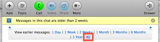

I'm not sure if this shows the entire history, but try the following. Whether the contact is online or offline, pop up the chat window.
Click blue chat button
Then click "All" under "View earlier messages:".
Click all
Alternatively, click the gear icon for the contact and select "View Chat History". That generates an html file that is opened in your web browser window.
The reason I'm not sure if this shows all the history is because I can't fully remember when my chat history began on this computer.

    Thanks for your answer. This seems like the way you're supposed to do this in Skype. The weird thing is that this will not work to find chats with people who are not on your list anymore. I'm not sure how that is supposed to be done. This also suggests that there is no way to do a keyword search. This type of message history interface is seriously weak compared to Adium's Chat Transcript Viewer. – hekevintran Jan 10 '10 at 01:13
  • I definitely agree. I really like Adium's chat history viewer as well. For Windows, I found an app called skypr (http://www.osiwanlan.de/skypr/) that I've never used, but it would still depend on there being chat history to display, which may not be the case for deleted contacts. – fideli Jan 10 '10 at 01:27
  • The chat logs with deleted contacts are in the log file. I just don't know how to get to them (or if you can even get to them) from Skype's interface. – hekevintran Jan 10 '10 at 01:35
