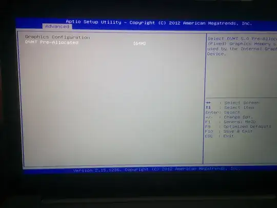

I own an Asus N550JV laptop, running Windows 8.1, it has an Intel I7-4700-HQ CPU and a Geforce 750M as dedicated GPU. But no matter what I try, I can't get the laptop to use my GPU. I've tried updating the Nvidia drivers and forcing the laptop to use the GPU in the Nvidia software. My laptop is plugged into the wall and the Windows energy profile is set to 'High Performance'. I've also tried to change settings in the BIOS but all I can change is the Integrated Graphics allocated Memory size.
In the pictures below you can see the options in the laptop's BIOS.

  • @BigChris It's a dedicated, embedded graphics processor, not an external graphics card. The term external is usually reserved for expansion cards. You don't have to disable the Intel graphics to enable Nvidia graphics. They can work in conjunction with each other. But unlike a CrossFire or SLI setup, they can't be used by the system as one. So you need a way to set a global system preference which one you want to use, and you do that in the BIOS if you have an option there, or in some control panel or utility software in the operating system. For Nvidia, that is Nvidia Control Panel. – Samir Jul 14 '15 at 14:49
  • Also, it is sometimes possible to start individual programs with a different graphics processor (override global preference). And for external monitors, they can be driven by the dedicated graphics processor, while the laptop monitor can be driven by the Intel processor. External video ports on laptops tend to be tied to the dededicated graphics processor if one is available. – Samir Jul 14 '15 at 14:57
  • Your latest comment is exactly what I'm trying to understand... and, then, why have an option in BIOS at all if BOTH can be used simultaneously...? – Kinnectus Jul 14 '15 at 15:00
