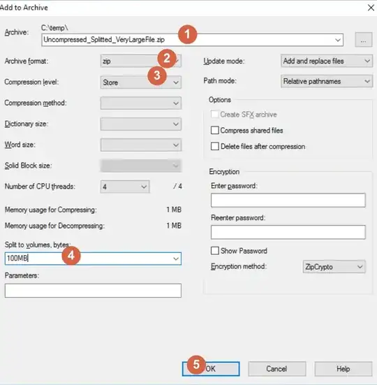

One can use 7-Zip to create segments of text file in certain size (e.g. 100 MB segments out of 1.5 GB log file).
The Key options are - Use "Store" as opposed to "Compress" - Use "Split to volumes"
You should be able to see text in .001 (.nnn) files.

  • The attached image is perfect! – Erik Nov 05 '18 at 13:04
  • Good alternative, without the need to install anything (most people have either 7zip or WinRar). I tried the different formats, and they all only store the header in the first file, the rest have no headers. The smaller headers are with zip and 7zip formats. With WinRar you can do the same thing, headers are also small, but it adds them to every file, so that's a little more effort if you need too many parts. – Andrew Mar 06 '20 at 02:28

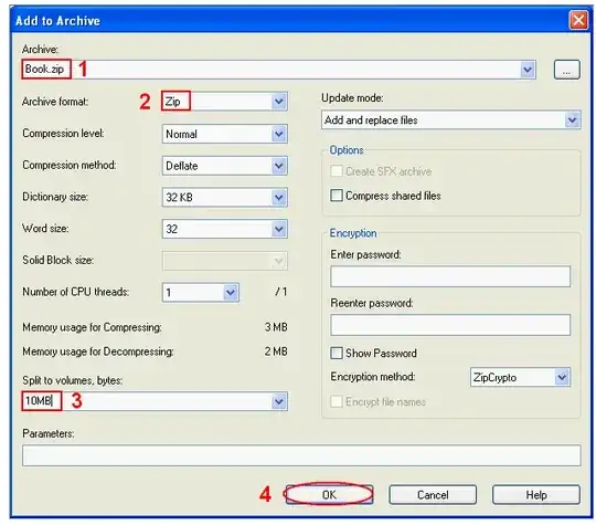

You can use 7-Zip itself to split the files. (You can save as a .zip or .7z format.) When you go to create the archive there is an option called "Split volume, bytes". Just select how large you want the chunks.
And yes, you can unzip them individually if you wish.
Split files in 7-Zip

    I don't think you can unzip them individually, you always need to start from the first file. What you can do is what other answer states: use compression level "store", so the file goes directly into the zip or 7zip file. Only the first file will have the header that you will need to remove. – Andrew Mar 06 '20 at 02:32
