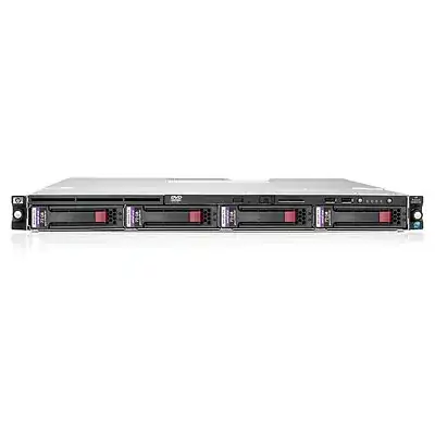

I'm trying to install Ubuntu 8.04 Server on an HP Proliant DL160 G6. The HP hardware is certified by Ubuntu for the 9.04 version, which I can't install due to company policy.
The problem is that Ubuntu would not recognize the RAID 1+0 disk configured by the BIOS. The raid creates one ~470GB disk from two 500GB physical disks.
alt text
Any ideas?
