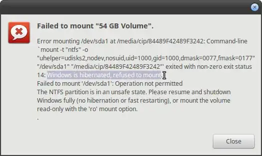

Following this solution to make a full shutdown in Windows 10 without disabling hybrid boot involving the command shutdown /s /t 0, the instalation partition of Windows 10 is not available in Linux:
The error message says that Windows is still in hibernation mode. So, that is not a full shut down.
The same happens after disabling hybrid boot completely, as indicated here.

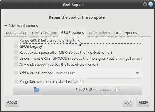

1. In order to restore Grub, boot in a live USB and install Boot-Repair. In Ubuntu:
sudo add-apt-repository ppa:yannubuntu/boot-repair&&sudo apt-get update&&sudo apt-get install boot-repair
Because I use a customized grub list (customized with Grub Customizer in one of my Linux systems) and because I wanted that list restored, I preferred the advanced options to re-install grub on that specific Linux system
(unimportant notice: the example image is not in a live session, where the "OS now in use" specification will be absent)
while un-checking the option to purge grub
Not purging grub is also a shorter and simpler process.
2. To access Windows partition from Linux Win10 hibernation/hybrid boot has to be avoided.
I first tried this solution to create a shortcut in Windows that would run the command
shutdown /s /t 0
to do a full shut down (without disabling hybrid boot for the normal shutdown command).
But that didn't work, as indicated in the updated question, nor did fully disabling hybrid boot as indicated here.
What worked was this solution to completely disable hibernation - source here:
