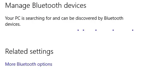

I want to disable Bluetooth on my laptop running Windows 10 Pro x64, but I have a problem: the option to do so is missing even though I know that it was previously available.
Here is the Bluetooth settings pages should look like on Windows 10:
Bluetooth Settings Page - Windows 10
Here is how it looks for me:
As you can see, I am missing the switch to turn it on or off? Why is it missing? I know that just yesterday, it was available and I turned it off. What can I do to fix it?

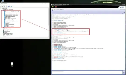

I had to open a ticket with the Intel support because uninstalling / repairing / installing the right driver wasn't working. The solution was to enter in the BIOS and setup the default setting. After reinstall the Bluetooth was back:
That guy saved my day.
Phoenix
  • 529
There are all kinds of problems that can cause this, judging by the amount of solutions I've found. Only one worked for me, so I'm adding this here.
I have a Dell XPS 13 9350 and had to do a reset of the BIOS to fix this. No idea what had changed in the BIOS, but multiple restarts didn't help. After resetting the BIOS to Factory settings (not BIOS Defaults, but I didn't try that), Bluetooth worked as expected again.
