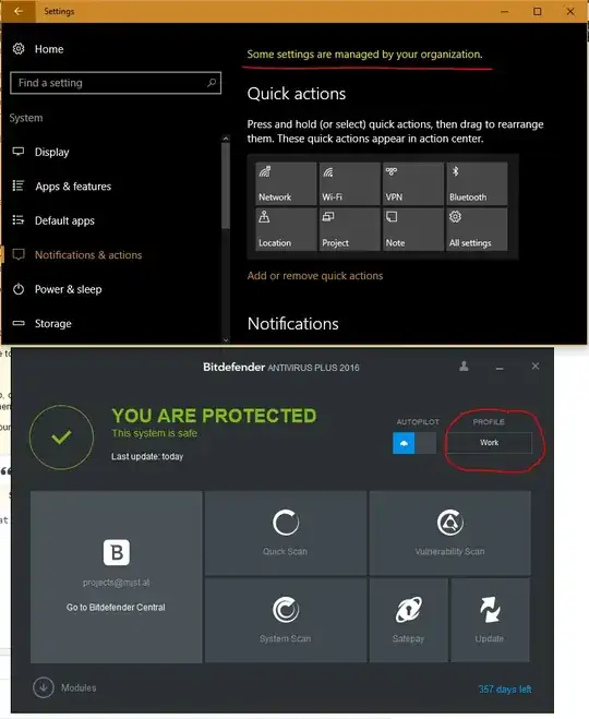

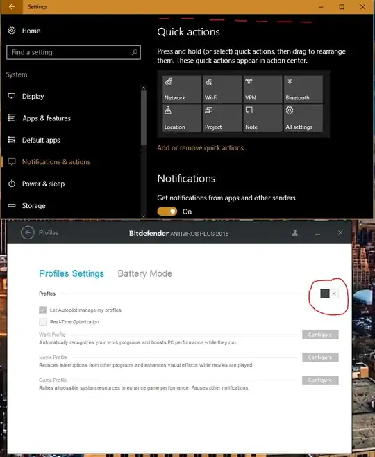

I hope, my answer isn't too late, but i noticed the following:
Some software out there is able to control these settings instead. In my case, those behavior is caused by the so called BitDefender-Profiles. See screenshots below.
managed 'by organization'... managed 'by organization'...
profiles off... BitDefender profiles turned off...
  • So..3rd party apps are allowed to manipulate my windows' settings? Nice... – arkon Sep 17 '16 at 21:25
    In my case, ESET manage my settings! – SeyedPooya Soofbaf May 25 '17 at 06:00
  • I'll just add that iolo System Mechanic will change this setting with its Privacy Shield (if you tell it to). I forgot I had turned off "Personal data collection and reporting", but your answer got my on the right track. – pppeater Oct 20 '17 at 17:30
