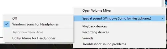

I had the sames issue, and I resolved it by checking Windows Sonic for Headphones (view image)enter image description here
Felix
  • 241
