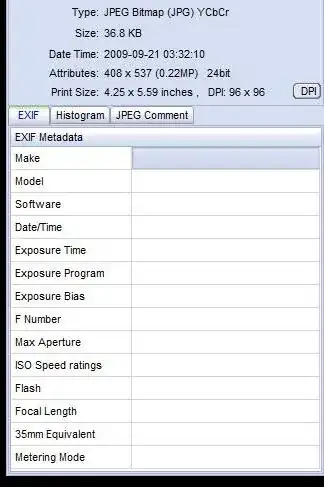

Exiftool: slow on the command line. (It's written in Perl, so draw your own conclusions there.)
Exifer creates an empty tag or two in files, and not just in the EXIF block. It will also remove some tags written by other tools. As I haven't used it in over a year, I can't be specific as to which ones.
FastStone's stuff, imx, is too slow to keep installed for more than a day or two.
My vote is for Hr. Weinzerl's suggestion: Exiv2.
