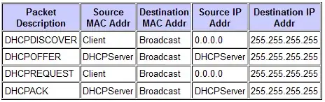

DHCP Discovery/Request
When a client boots up for the first time, it is said to be in the Initializing state, and transmits a DHCPDISCOVER message on its local physical subnet over User Datagram Protocol (UDP) port 67 (BootP server). Since the client has no way of knowing the subnet to which it belongs, the DHCPDISCOVER is an all subnets broadcast (destination IP address of 255.255.255.255), with a source IP address of 0.0.0.0. The source IP address is 0.0.0.0, since the client does not have a configured IP address. If a DHCP server exists on this local subnet and is configured and operating correctly, the DHCP server will hear the broadcast and respond with a DHCPOFFER message. If a DHCP server does not exist on the local subnet, there must be a DHCP/BootP Relay Agent on this local subnet to forward the DHCPDISCOVER message to a subnet that contains a DHCP server.
This relay agent can either be a dedicated host (for example, Microsoft Windows Server), or router (for example, a Cisco router configured with interface level IP helper statements).
After the client receives a DHCPOFFER, it responds with a DHCPREQUEST message, indicating its intent to accept the parameters in the DHCPOFFER, and moves into the Requesting state. The client may receive multiple DHCPOFFER messages, one from each DHCP server that received the original DHCPDISCOVER message. The client chooses one DHCPOFFER and responds to that DHCP server only, implicitly declining all other DHCPOFFER messages. The client identifies the selected server by populating the Server Identifier option field with the DHCP server's IP address. The DHCPREQUEST is also a broadcast, so all DHCP servers that sent a DHCPOFFER will see the DHCPREQUEST, and each will know whether its DHCPOFFER was accepted or declined. Any additional configuration options that the client requires will be included in the options field of the DHCPREQUEST message. Even though the client has been offered an IP address, it will send the DHCPREQUEST message with a source IP address of 0.0.0.0. At this time, the client has not yet received verification that it is clear to use the IP address.
Client-Server Conversation for Client Obtaining DHCP Address Where Client and DHCP Server Reside on Same Subnet
Enter image description here
Source: Understanding and Troubleshooting DHCP in Catalyst Switch or Enterprise Networks
