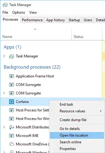

After playing around with it a bit, and I think I found a method.
Open Task Manager and have it show More details. Right click on Cortana and select Open file location.
Task Manager
Now find the Cortana folder, right click it, and select Rename. I would recommend just adding ".bak" to the end of the folder name so you can find it easily if you want to restore it back to it's original status.
Rename
If you attempt to rename, it will tell you that the folder is in use.
Folder In Use
This is when you want to go back to Task Manager, right click on Cortana, and select End task.
End task
Right after the task ends, switch back to the Folder In Use window and click Try Again. The folder should be renamed and the Cortana task will not start again.

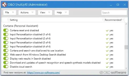

The easiest way to disable certain privacy aspects of Cortana is to use a third-party tool such as O&O Software's free ShutUp10.
Cortana in ShutUp10
Part of Cortana, though, is Windows Search, so there would still be an occasional Cortana process such as file indexing. However, there should no longer be any use of the internet by Cortana.
You can remove Cortana completely, if you wish, but that also removes Windows Search (though that might not be an issue if you use a third-party tool such as DocFetcher or Mythicsoft's Agent Ransack, which provide increased search functionality). That said, after a Windows 10 update, expect that Cortana would be reinstalled. Apparently, the only way now to permanently avoid Cortana is to use another OS, such as Linux.
