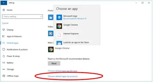

If Firefox is not even listed as a browser option (like in the picture below). Click on the link to "Choose default app by protocol"
Default Browser Options
Once that is open, find every protocol where your current default browser is listed (in this case Chrome), and change it to Firefox.
setting default protocol
