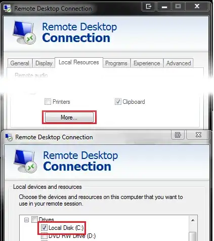

Assuming you're talking about Windows Remote Desktop Connection — before you hit Connect, click Options to expand the RDP connection window.
Click the Local Resources tab. Under Local devices and resources, click More.
In the new window, click Drives. Click OK to close.
Go back to General tab and click Save to save the settings for next time.
Barring any weird settings on the server side, you should be good to go.

4Pretty much follow the same steps as technie007 suggests, but also notes the clipboard option. – huggie Jan 14 '10 at 07:06
1This solution solved my problem but I don't like it. I don't want to give the remote computer (read/write) access to the whole drive(s). – Isaac Dec 06 '12 at 14:57
That is definitely a cleaner interface than copy-pasting through the rdp session, though it also verified my worry that the reason the other method didn't work is that this particular vpn connection just really doesn't like copying files. >.> – neminem Dec 19 '14 at 19:25
2If you try this and it still doesn't work, you might need to kill and restart the `rdpclip` process. See here: http://www.gfi.com/blog/copy-paste-working-remote-desktop-connection-whats-wrong/ – degenerate Jun 22 '15 at 00:47
@degenerate, Weird, I don't see a `rdpclip` process anywhere on the client. Which Windows are you using? – Pacerier Aug 03 '15 at 05:17
3dont work, this is good solution: http://superuser.com/a/118675/199176 – Nabi K.A.Z. Feb 15 '16 at 17:19
So my problem was because i was on windows 10 and i used the "History" result-ish kind of suggestion underneath the "remote desktop connection" when i searched "Remote" in start menu search, seems like it uses different settings when doing that rather than opening the remote connection manually... so thats why i didnt get the copy to work, because apparently when you do that its using different connection properties . .. – Niklas Sep 02 '17 at 05:48
@Isaac then just create a new virtual drive. Windows already has the ability to mount VHD files for a long time – phuclv Dec 11 '19 at 00:02
I don't see how this answer fits the question. The question is about copy-paste (in general), the answer is about copying and moving files through clipboard in explorer... – pgr Apr 26 '22 at 15:27

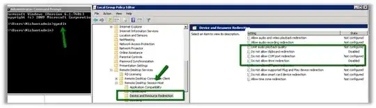

if you are SuperUser (Adminisitrator) on the Remote Computer do the followings;
- Click Start
- Administrative Tools
- Terminal Services
- Terminal Services Configuration
- Double click RDP-Tcp connection under Connections
- Click Client Settings
- Uncheck Clipboard under Redirection (if it is checked that means it is disabled)
This may solve your problem which solved mine.

for anybody wondering, this is under the tree User Configuration -> Administrative Templates - > Windows Components -> Remote Desktop Services -> Remote Desktop Session Host -> Device and Resource Redirection. Disable the "do not allow clipboard redirection" – LarryBud Oct 20 '22 at 16:08
