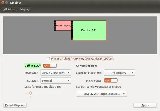

I have a DELL E7450 laptop connected via an HDMI cable to a DELL UP3214Q monitor (which can display 3840x2160 @ 60Hz with a DP1.2 cable) . Ubuntu 14.10 uses the 3840 X 2160 resolution just fine - although @ 30Hz (which I don't mind). No drivers required. xrandr shows:
HDMI1 connected 3840x2160+1920+0 (normal left inverted right x axis y axis) 698mm x 392mm
   3840x2160      30.0*+   25.0     24.0     30.0     24.0
   1920x1200      60.0
Ubuntu 4K

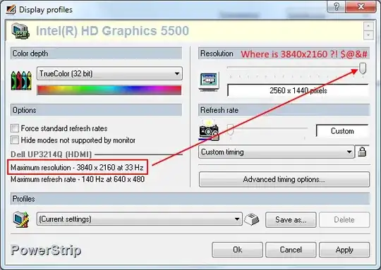

But Windows 7 64-bit only sees 1920x1080 as the maximum resolution. The Intel HD Graphics 5500 settings allow for custom resolutions, but the maximum I could set was 2560 x 1440 @ 30Hz. Beyond that, everything would error with
The custom resolution exceeds the maximum bandwidth capacity
This error is obviously completely bogus!

  • Installed Entec PowerStrip. It detects the maximum resolution but can't set it, even after adding it from Custom Resolution. enter image description here

  • [This](https://software.intel.com/en-us/articles/quick-reference-guide-to-intel-processor-graphics) says maximum resolution is `HDMI: 4096 x 2304, 3840 x 2160 @ 24 Hz / 24bpp`. Not sure why it would be different in Ubuntu. Was the 60Hz actually there? – MC10 Aug 14 '15 at 16:25
  • @MC10: actually I didn't explicitly see 60Hz (added a screenshot), but never saw anything slower than I'm used to. By comparison, the 30Hz custom resolution in Windows was just *bad* - even the mouse moved visibly more slowly. – Dan Dascalescu Aug 14 '15 at 16:56
