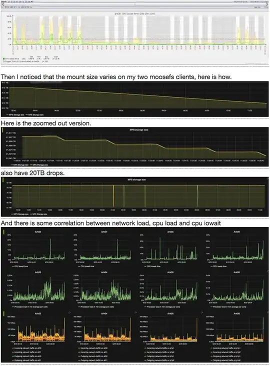

I have 4 moosefs chunkservers with 8 2.7 TB storage on each, I mount them using mfsmount and then export with nfs. Recently I noticed high iowait on my chunkservers, then huge mount size drops, see the graphs. enter image description here

  • which version of MooseFS do you use? Why do you re-share MFS via NFS? Do you **really** need it? Your charts are very compressed, it is hard to see anything in legend. Could you post a bigger image? – prk Aug 20 '15 at 10:15

The reason of this problem was the RAM on mfs server, it started to use 50% of swap, when I increased the RAM, everything started to work as expected, but still high iowait exists on chunk server, I guess that we should move from jbod to some kind of raid.
