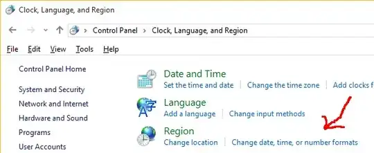

Have you tried to:
  • Go to "Settings" -> "Language and Time" -> and on "format" -> "change date and time formats"?
  • Or go to "Control Panel" -> "clock, language and region" -> "change date formats, time or number" and then change the format? You can also have look at "Additional settings" on that window to see if everything is formatted as expected.
If none of that works, I think only solution will be editing the windows registry. There are some tutorials for Windows 8. I think it will be compatible with Windows 10 too.
