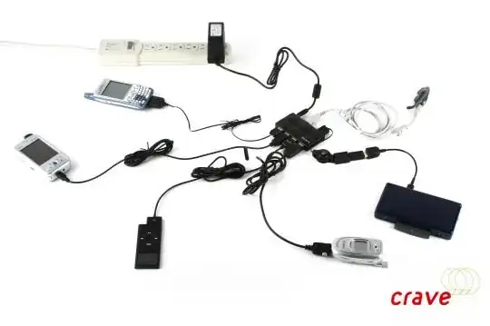

Check: Transform a USB hub into the ultimate DIY gadget charger
I'm talking about a standard USB hub--those little accessories that multiply one of your PC's USB ports by a factor of four, five, six, or even seven. I took a spare seven-porter--the Belkin F5U701 ($20)--plugged its included AC adapter into a nearby wall outlet, and started loading it up with devices. A few minutes later, I was charging six devices via USB with no apparent problems--and I still had a free port available for yet another device.

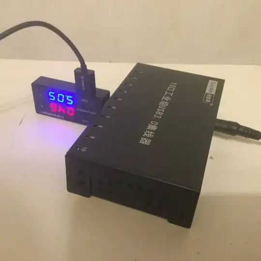

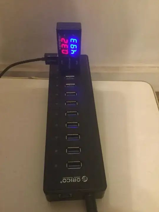

Just checked and find out that it may depend both on hub and on device.
So, I checked 2 hubs:
with 2 devices - phone and tablet.
They both were charging phone, but Orico hub couldn't charge tablet (current was 0, but with computer it's higher then 1A). Sipolar hub successfully charged both devices.
Also note that hubs can give higher current (up to 2A for these hubs), but the voltage is always 5V, so no fast charge with 9V.
