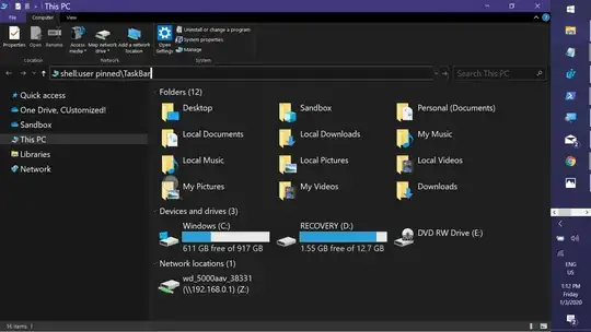

To get there quickly without worrying about Explorer view options, click in the Explorer Address bar and type:
shell:User Pinned\Taskbar:
