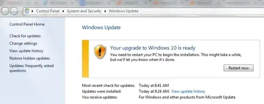

I agreed to download Windows 10 and now it is downloaded and ready. I want to be able to control when it installs, possibly weeks from now. I'm currently on Windows 7.
I have been prompted with an option to choose which one of the next 3 days I would like the installation to happen on. There was no option to postpone it for longer, so I picked the third day.
However it seems like it will install the next time I restart, and I don't want that to happen. (see screenshot)
How can I cancel the upgrade?
Your upgrade to Windows 10 is ready
