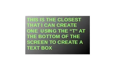

I can't find the setting to make rounded corners. I have clicked everything that says "rounded". No effect.
What do I do to get a box like this original author has ?

The rounded edges that I'm see from the other guy
The sharp edges which I want

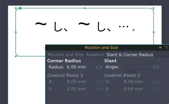

  1. Select Text Box
  2. Menu: Format->Object and Shape->Postition and Size->Slant & Corner Radius tab (Shortcut F4)
A text box with rounded corners and the settings dialog
