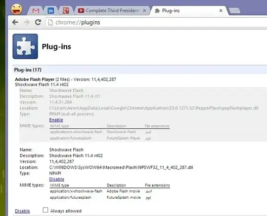

I had a different problem where speaker fill WAS working for all windows sources like iTunes, Media Player, Winamp, etc however Pandora via Chrome was not filling for some reason.
I found this solution: https://plus.google.com/+UweTrottmann/posts/NkJtxz7iHMP
  1. Go to chrome://plugins/
  2. Expand the "Details" [+] button
  3. Disable the flash plugin that is NOT installed in your windows directory
  4. Restart chrome and enjoy speaker fill from Pandora
