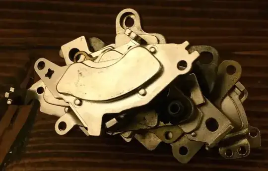

Positive side of an utterly dead hard disk drives? The rare earth magnets they contain are nice, strong and cool to reuse and/or collect. Here’s my little stack of dead drive magnets:
