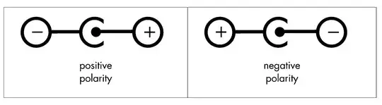

  • Other than checking polarity of the plug, It should work fine, I have done this many times, if voltage is within 1~2 volts and amperage is same or higher you are ok. – Moab Sep 09 '15 at 15:35
No, that's well within the tolerances of both supply and laptop, you shouldn't have any problems assuming both have the same pin configuration, almost certainly centre-pin positive.
