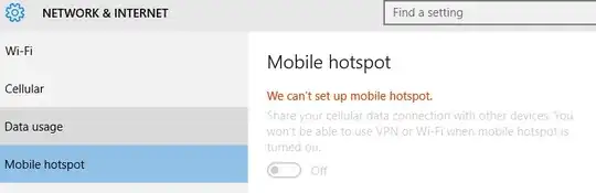

I am trying to set up a mobile hotspot in Windows 10 but the settings are disabled and the error message does not explain what the exact problem is.
Error in Windows10 settings dialog
The machine in question is a VM in VMWare Workstation and has a Wi-Fi and a cellular USB-stick attached. I had tried MyPublicWiFi before I discovered that Win10 had built-in settings for this, but now I have uninstalled MyPublicWiFi.
So, does anyone know what could cause the above mentioned error message?
Edit: I still don't know the reason for the error message, but it went away after I used a different Wi-Fi USB-Stick!

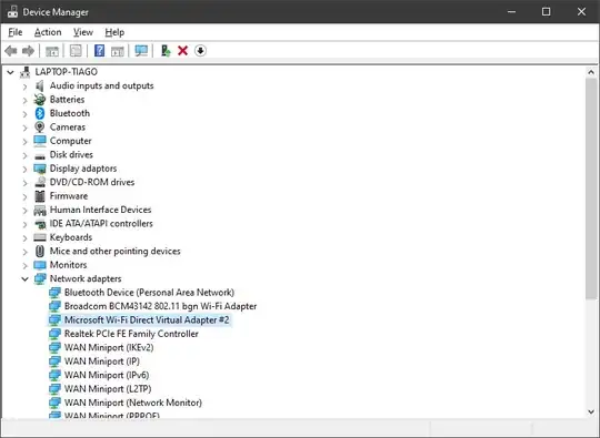

    In windows search box type `Device Manager` and open it. In `Device Manager` menu `View>Show hidden devices` click on that. Now you will find the `Network adapters > Microsoft Wi-Fi Direct Virtual Adapter `, So just disable and enable it. Its resolve my problem. – Kushal Suthar Jan 18 '19 at 06:37

Troubleshooting: If you find any errors such as "The group or resource is not in the correct state to perform the requested operation.": enter image description here
  • Type Win+X
  • Go to Device Manager
  • View / Check Show Hidden Devices
  • Search for a Network driver called "Microsoft Wi-Fi Direct Virtual Adapter"
  • Disable / Enable it enter image description here

  • Now you might be able to enable it enter image description here

I got this error after connecting/disconnecting another wifi adapter. I went to Device Manager and disabled then re-enabled the original adapter and the error went away
