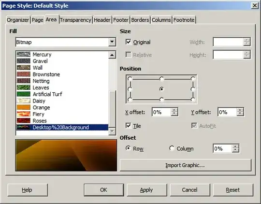

How do I set a page background image to a customised bitmap?
The missing step in your question is importing the bitmap using Draw
  1. Import the bitmap to the "Fill" list using Draw (this step is not required in Libreoffice 5.0.1.2)
  2. Set the page background image using Writer
Note:
  • The lastest version of Libreoffice 5.0.1.2 has an additional "Import Graphic" button on the "Area" > "Bitmaps" dialog so step 1 above can be omitted.
  • Close Writer
  • Open Draw
  • Menu "Format" > "Area"
  • Select "Bitmaps" tab
  • Click "Import"
  • Choose a bitmap
  • Give the bitmap a name
  • Press OK
  • Press OK again
  • Here I have added a bitmap named "Desktop Background"
  • Close Draw
  • Open Writer
  • Menu "Format" > "Page"
  • Select "Area" tab
  • Set "Fill" to "Bitmap"
    • Press "Import Graphic" (Libreoffice 5.0.1.2)
  • Select a bitmap
  • Press OK
    Libreoffice 5.0.1.2:
    Libreoffice 5.0.0.5 (Note missing "Import Graphic" button)
  • Here I have selected the bitmap "Desktop Background" added previously

If you open Format --> Page in Libreoffice Writer 5 and go to Area tab, clicking on Import Graphic button allows you to choose your own image.
You can set size, position and tiling (repeat it multiple times in background)
Then, it will be your page background.

  • I'm on 5.0.0.5, and the dialog looks *exactly* like yours, except it is missing the `Import Graphic…` button. I will update to 5.0.1 sometime during the next days and see if I can reproduce your answer. – Jörg W Mittag Sep 12 '15 at 09:32
