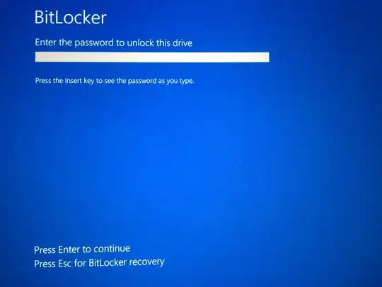

When entering the Windows boot manager, I'm still prompted for the password, but after that, I get a screen saying
Your PC/Device needs to be repaired
An unexpected error has occurred.
Error code: 0xc000000e

The Windows boot manager with the original BCD:
asking for password
