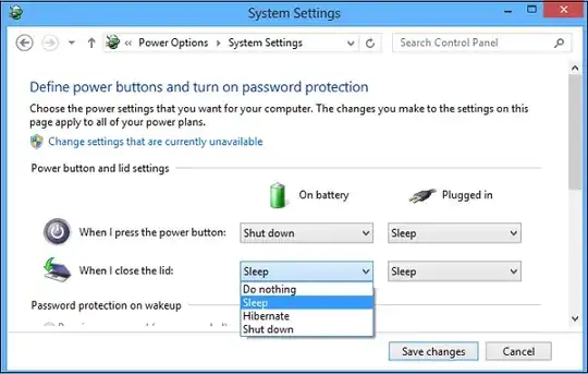

Press Windows+R, and in the 'Run...' box, type powercfg.cpl and press Enter. This will open the Power Options:
The Power Options Panel
Click the 'Choose what closing the lid does' link from the left side panel, and under the 'When I Close the Lid', change the setting to 'Do nothing' when Plugged in.
Changing the action on lid close
I recommend leaving the 'sleep on battery', as you'll usually want your laptop to conserve power whilst on the move.
