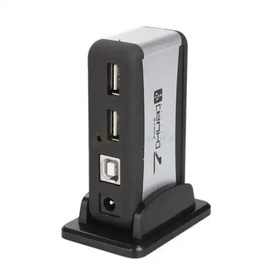

I recently bought a USB 7 Port Hub with external power supply, but unfortunately it got burnt out. I have searched everywhere using the keywords that I know but unfortunately can only find diy guides and hubs with supplies. The original cable that came with it is:
[this][1].
The hub is:
Giacomo1968

    You say the power supply burned out, correct? In the U.S. this is typically called an AC power adapter and for a USB hub the output voltage would be something around 5V DC. That said, are you 100% sure the AC power adapter is what died? On many of these kinds of hubs, the hubs them selves burn out. Especially the connector that would be the receptacle for this AC power adapter. Just something to keep in mind as you attempt to fix this issue. – Giacomo1968 Sep 18 '15 at 17:18
    I agree - I would definitely consider that the hub might have died. I have what appears to be an identical version of this one and it just recently stopped working correctly. I think in general these hubs have pretty low reliability. Note that for devices that don't need extra power, you can still connect them to your computer through this hub, so you should be able to verify whether the hub is the problem or not. If you have a voltmeter you can also check whether the AC power adapter is working or not. – kldavis4 Sep 18 '15 at 19:16

This is a very generic AC to DC adapter. There is no specific name for it. All further assumptions are based on the pictures you have provided. Any damage or harm that can possibly occur is your own responsibility
The picture you have supplied is showing a standard 5V DC power adapter. The are very common and don't cost much.
To order the correct replacement you will need the following data:
  • Input voltage (in your case it seems to be 115 VAC)
  • Output voltage (in your case it is 5V DC)
  • Output polarity (in your case it is inner positive, outer negative)
  • Output current (can't read on the image, but has to be at least what your original adapter specifies or more, within reasonable margin)
  • Outer plug diameter (you will have to measure)
  • Inner plug diameter (you will have to measure)
Then just go on eBay and look for "5 VDC adapter x.x mm y.y mm" where x.x and y.y are inner and outer diameters in mm and make sure you pick one suitable for the location where you live (USA, i assume). And don't forget the polarity!
Also note, that if you have fried your previous adapter, there might be a fault in the actual hub which will result in too high current and fry any other adapter connected.

  • “…there might be a fault in the actual hub…” Bingo! Also, the original AC adapter might not be “fried” at all; it could be the HUB itself. – Giacomo1968 Sep 18 '15 at 17:26
