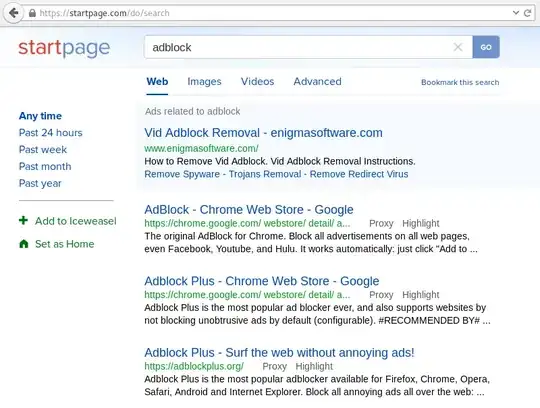

I tried the following, it has no effect:
startpage.com##[style*="background-color:#F5F9FF;"]
Any idea how to solve this?
To reproduce: Go to https://startpage.com/do/search - search for example for adblock. You'll see nasty light blue boxes at the top and bottom of the page reading "Ads related to adblock":
This is with Iceweasel (Firefox 38.2.1) and Adblock Edge 2.1.9.1.
If it's not possible, which secure/privacy-respecting and ad-free sites do you recommend as alternative to IxQuick and Startpage?
  • I couldn't find the ads displayed in Chrome with Adblock installed. Even if I disable Adblock extension I could see the text that were being displayed in your screenshot. :/ So, my guess is that one of the extensions that you are using in injecting the ads in that page. Could you disable all the extensions, restart your browser and check again. – Lucky Sep 29 '15 at 09:16

  • Thanks. Apparently it's either a bug in Adblock Edge or some counter action taken by the site. Because I just noticed that the ads are _outside_ the `div.spon_links` when Adblock Edge is enabled. It _does_ have a filter rule for `spon_links`. Perhaps there is some JS that moves the `ol` elements somewhere else when the `spon_links` is filtered. –  Sep 29 '15 at 09:18

Following @DavidPostill's notice, I looked again at the page structure. It appears that the text ads are moved outside the div.spon_links when Adblock Edge is enabled which indeed has a filtering rule for spon_links. Whether this is a misbehaviour of Adblock Edge or some counter-action from Startpage I don't know.
There is a simpler solution than adding a custom Greasemonkey script—simply swapping Adblock Edge for uBlock also solved the problem.
On further investigation, the ads only disappear with uBlock enabled when Adblock Edge is entirely disabled at the same time ("Disable everywhere"). Even if I disable it only for Startpage ("Disable on startpage.com"), the site moves the ads outside the spon_links container. My explanation is that Startpage somehow manages to access my Add-ons preferences and checks if Adblock is generally enabled. Could it be that nasty?!

  • Yes, it is that nasty. There is some JS there which is definitely checking for the existence of some (Chrome?) extensions, and that appears to be where it is detecting adblock. – Kevin Brown-Silva Sep 29 '15 at 15:07
