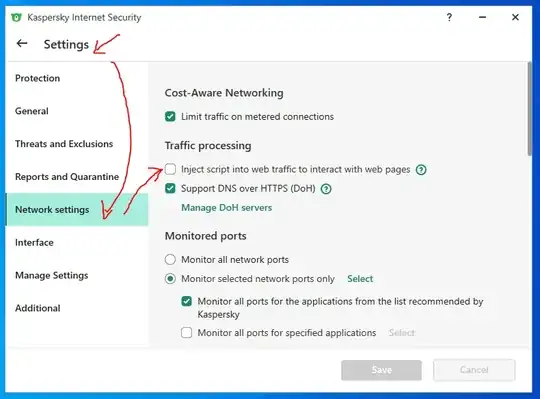

There is a setting to disable script injection in the newest Kaspersky version (>16.0.1):
Settings -> Additional -> Network -> Inject scripts into web traffic to interact with web pages.

Follow the screenshot instruction on the latest version.
Madan Sapkota
