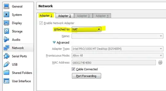

The first adapter must be set to NAT mode, which enables the guest to access network resources (including the Internet) through the host's network interface.
Adapter 1: NAT

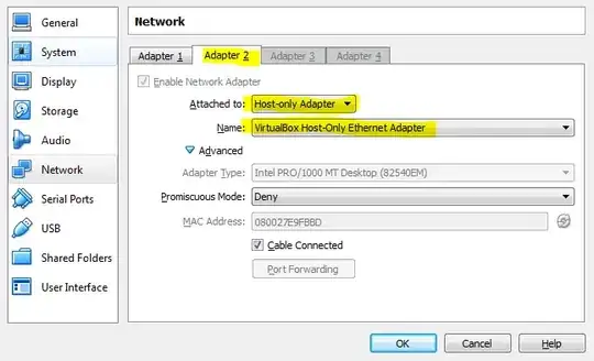

The last step with regard to configuring VirtualBox is to go back into the VM's network configuration and add the second adapter, which references the host-only adapter that we just created:
Adapter 2: Host-only

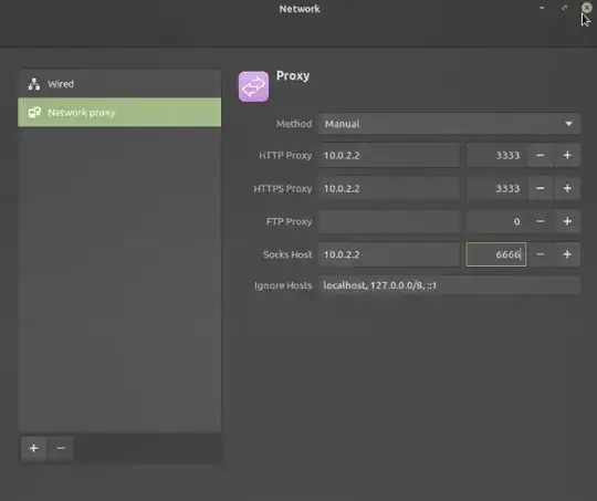

How i use my Windows host VPN in guest Linux machine
1-) Open up your VPN settings. Specify some local port numbers.
vpn settings

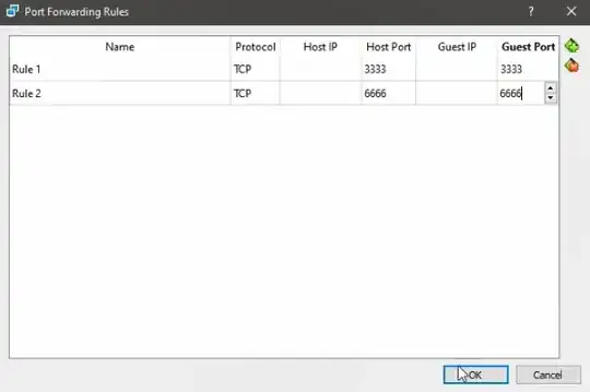

2-) Open up your virtual machine settings. Make sure nertwork is attached to NAT. Then click advenced and port fowarding
3-) Click to add rule and enter the same port numbers you have specified in your VPN
port fowarding
4-) Start your Virtual Machine. Go to your Network Settings. Select manual and enter 10.0.2.2 (Default virtualbox NAT Gateway) on ip adress and the ports we have specified before.
linux network settings
5-) Open up firefox and go to whoer.net and check if your VPN works. ALL DONE
